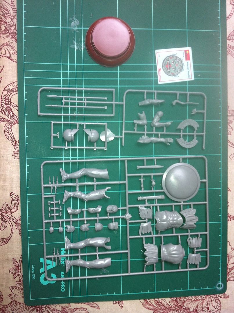

NO construction/ instruction sheet included and there ARE parts that arent immediately clear what they are or where they go....But in fairness a nice coloured painting guide is included and a decal for the ' scarey ' face on shield .Will probably ignore the checkered pattern on helmet ...and maybe even the miles of white trim around edge of 'skirt' (does it have another name?) tassels .

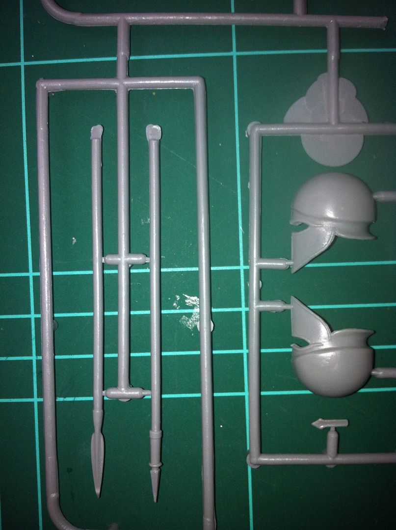

Distinct bit of flash on sprue near helmet ,and most parts need some cleaning up .
Spear nicely moulded but a bit bent at the business end .
Face/head with (inevitably badly fitting ) joint lines in terrible positions

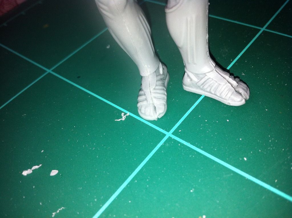

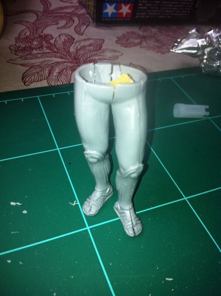

Fit is AWFUL!(Two legs not glued together yet.Smoothered in superglue awaiting sanding .I know its best sanded in first 20 minutes and can become 'too' hard but me n Darius are 'on a break' )
CLOVEN HOOF! :-(
In fairness its worse on his left as I started to glue the halves 'from the top'/thigh with superglue and it started to dry/harden .Starting at the sandal/foot allowed the most critical part (at least below the waist -arms look even worse -and head should be fun!) to be squeezed as tightly together as possible

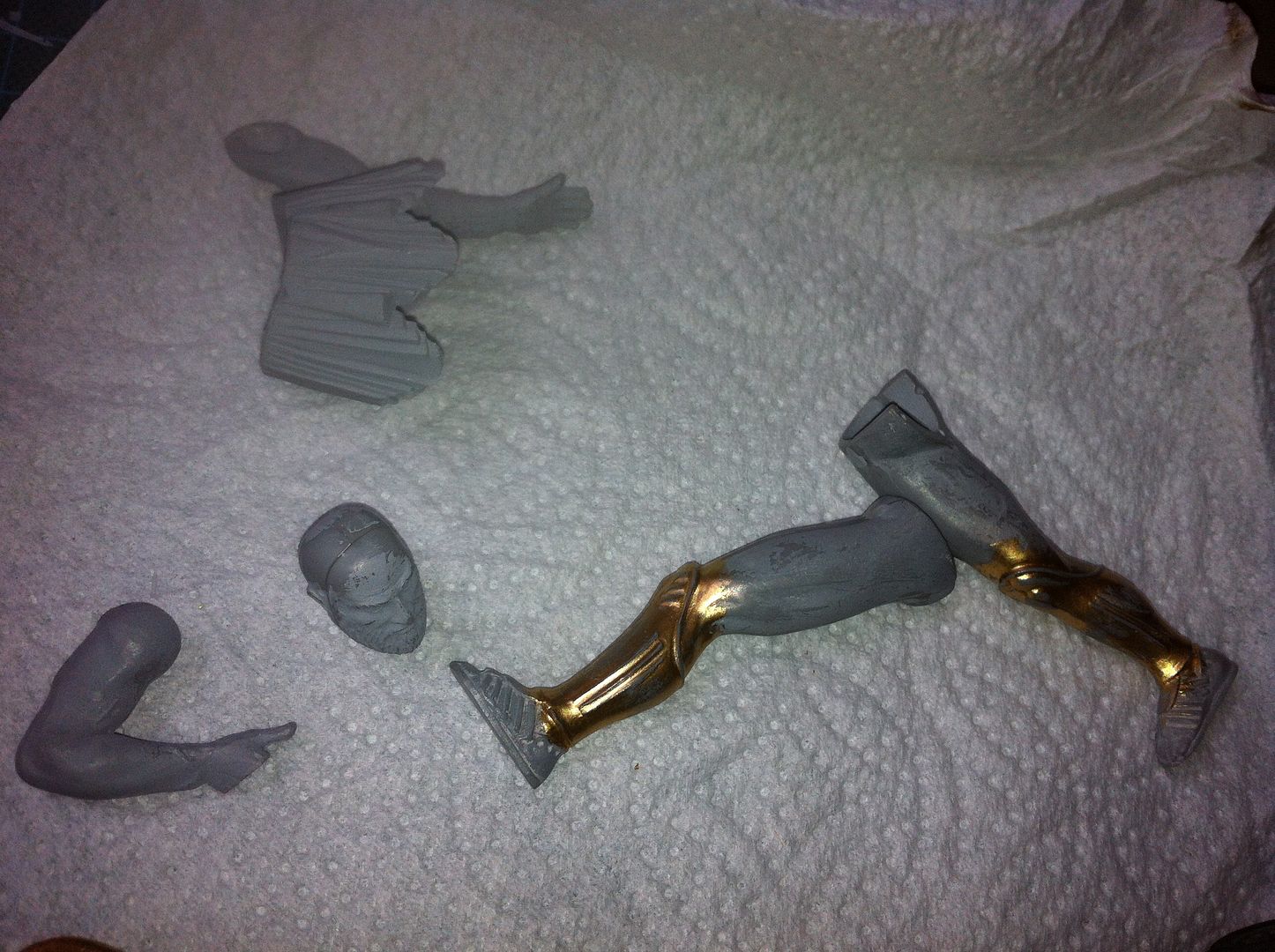

Spent 2 or 3 hours on this and have done a bit since last update .Trying out uploading pics directly from phone rather than via PC
Eureka ! It worked !App is called Piccup .Flickr Wasnt iOS 7 compatible .(Dont have room to install iOS 8) Anyway above are the two back halves of head .I figured Id may as well tackle face painting as there's no point in killing myself building rest of HOPLITE if at the end of it all his eyes are going to look like crazy tennis balls .I know that sounds 'defeatist ' but there's bound to be some compromises in this build eg look at front of shield ,( in first post pic )ONLY the face is included as a decal .Im fairly sure I won't be doing the squiggle artwork around rim
Used superglue carefully dropped 'on top' of hand held joint .I often find it dries so fast it's hard to work for anything but the shortest joints ( and once it dries ,particularly if accelerator is also used, it's hard to remove neatly )Of course the answer would have been to use Tamiya STANDARD not 'extra thin ' liquid cement as recommended by Tony Crean to me at D4 .Its only €3.50 from HobbyDen .Its even better at joint ' sandwich filling /butter squeezing out'!) than Extra Thin but doesn't evaporate as quickly and is stronger .The brush isn't great though and you should temporarily swap,it with your Extra Thin bottle one ) Maybe this stuff dries rock hard in hours but I'd feel safer leaving it at least overnight .

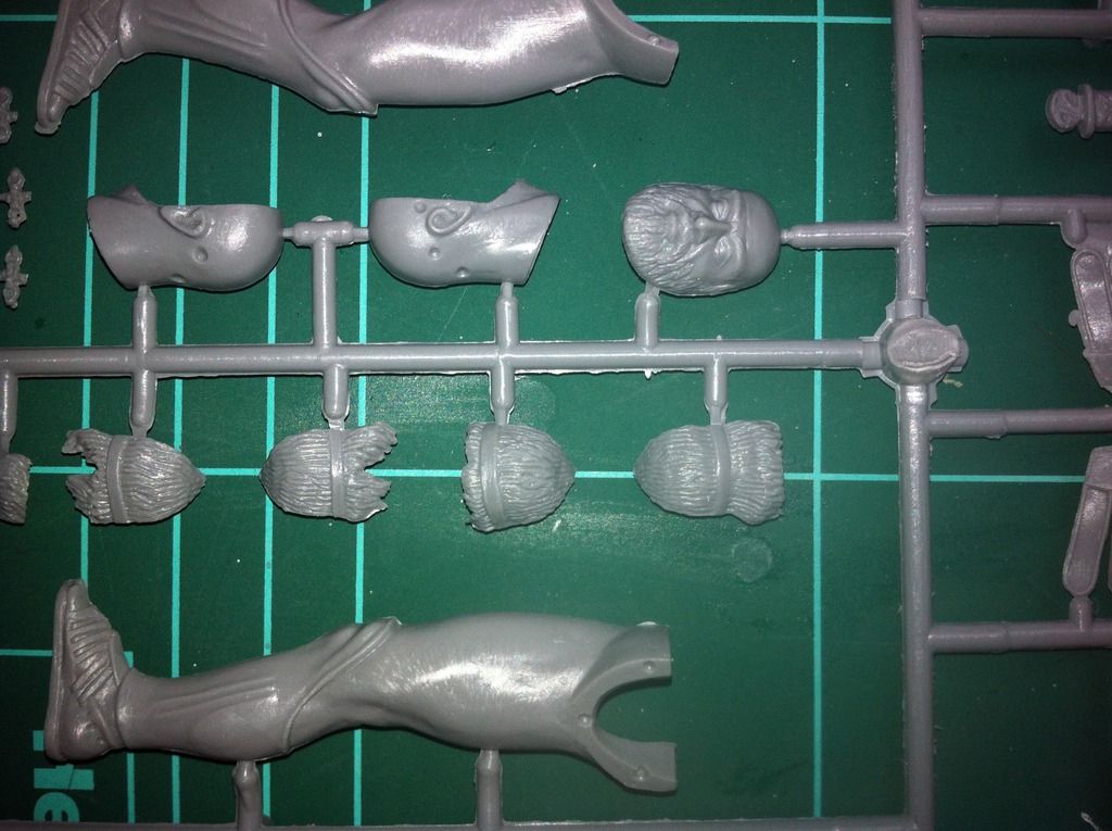

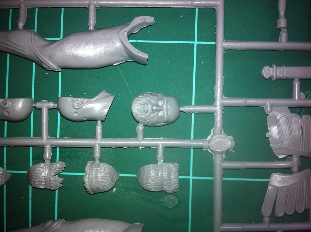

There IS hair to fit on head but it doesn't look great ( in 4-6 pieces ) and I put a lot of work into sanding skull ( before remembering that real skulls HAVE joint lines -Jeez it's the Bf109 fuselage all over again !)

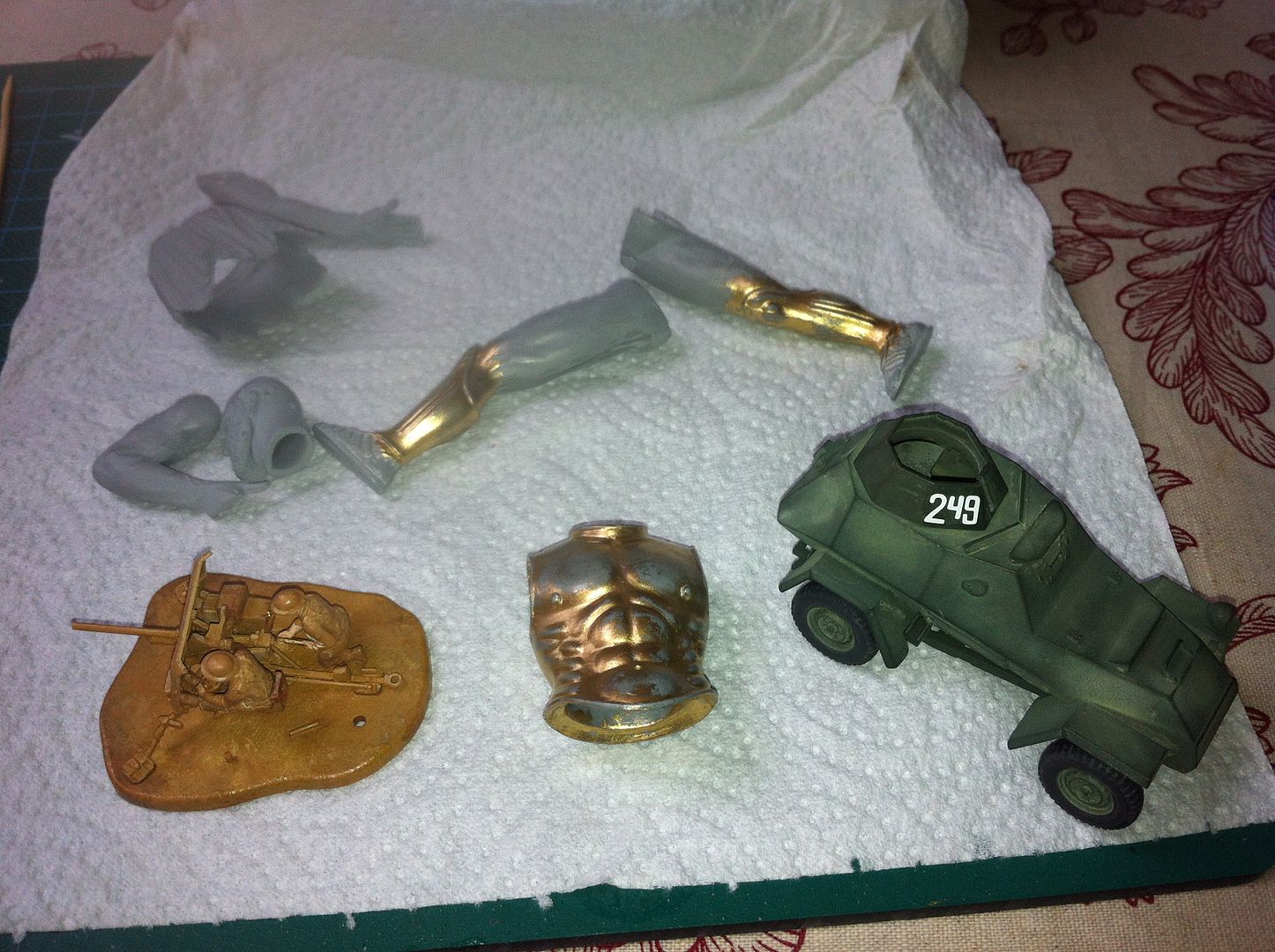

Another 2-3 hours modelling today .

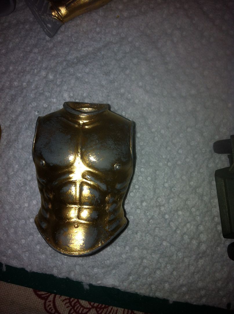

Got decals on BA64B and glued figure to seat of gun before trying Vallejo Model Color metallic 'liquid gold' alcohol based paint on shell casings
and then throwing a bit (by brush) onto the cuirass(armour breast plate) and greaves (shin guards)
I wasnt that careful with brushmarks and some 'sediment '(it dries lightning fast) developed which I mostly bufffed/polished off with a paper kitchen towel
While the adhesion /stickiness mightnt be great theres no arguing with the shine .Anyway I think those 'high ' areas that paint was more prone to coming off on is ideal for 'highlighting' perhaps by airbrushing a lighter shade (practically white?)

The gold looks really good on the breastplate. Looking forward to seeing this come together
Would you believe I got it FREE from Prince August by guessing the scores of some matches in European Champions last Summer .Im not a soccer guru at all but was lucky enough to thus win two separate €5 vouchers from them.I bought a good few Vallejos with my winnings .Theyre currently running a sale with selected Vallejo paints for a euro plus vat . Regular price is €2.40 .An Irish institution and all round lovely folk
http://shop.princeaugust.ie/metallic-acrylic-base-paints/
I only lashed it on by brush and rubbed out the 'dry lumps' with a kitchen towel .Id say airbrushed (outdoors) on a smooth well primed surface it could look great .

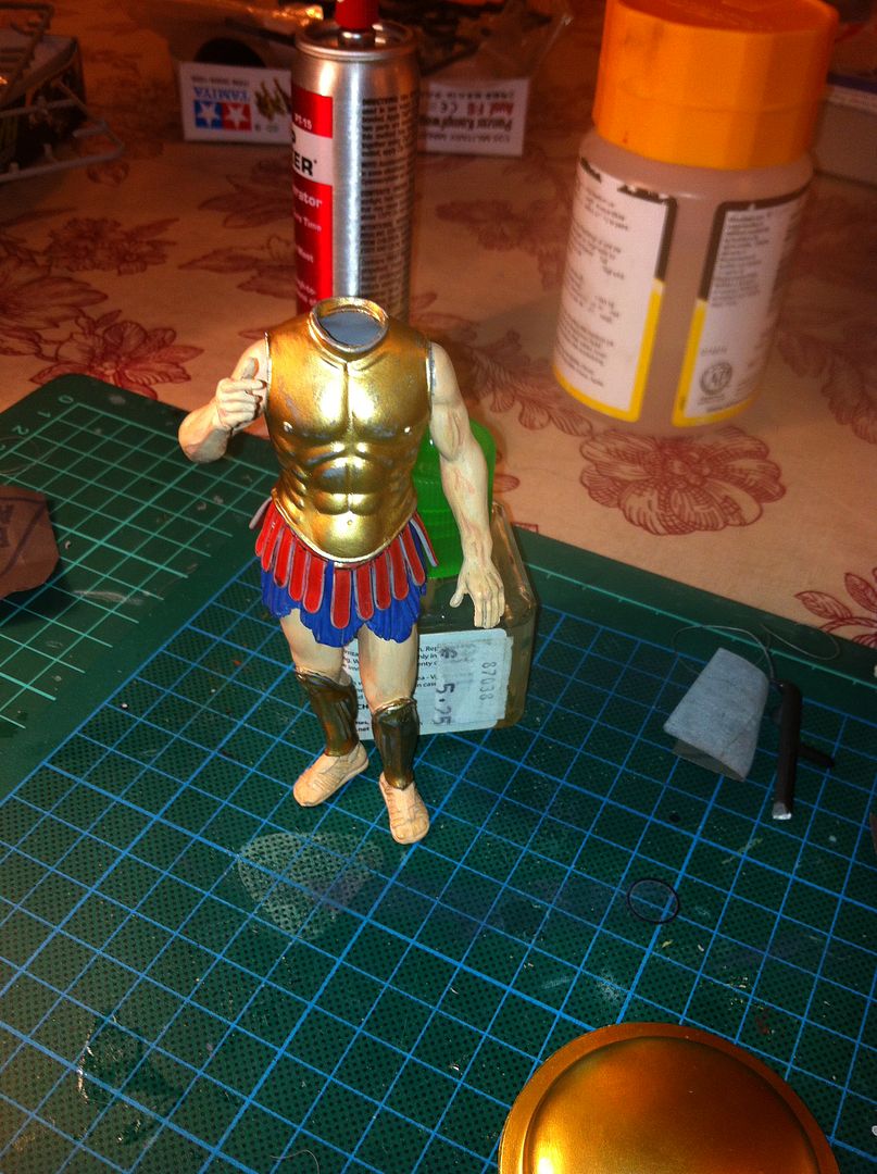

Just spent a good chunk of the day with barely a 'Wonder Woman' skirt to show for my trouble -as you do
Tasselled skirt made of heavy leather protective strips comes in four pieces .Originally painted the outlines black but meant to be 'white ' .That and lots of flash meant it looked wrong and I had to start from scratch with wet and dry paper .Managed to simulate the lighter coloured (raw leather?) edges by just sanding /scraping off the red or black paint to reveal grey primer/plastic underneath . Lots of touch ups will be needed
( You can see the two sections on the right have both their 'outer right' hand side tassels short moulded )
Getting these four bits anyway right looking is like a plastic surgeon trying to get 'The Man From Atlantis 'hands to look 'normal ' !!!( Obscure reference I know but we're mostly aul fellas here after all)
Gluing parts together was tricky also .Unbelievable that this kit has no construction instructions whatsoever .It badly needs them !
Cuirass /breastplate will hide those misaligned bits hopefully .

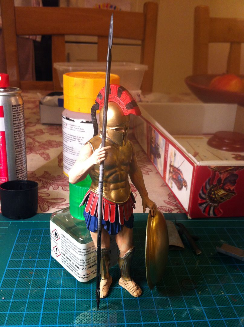

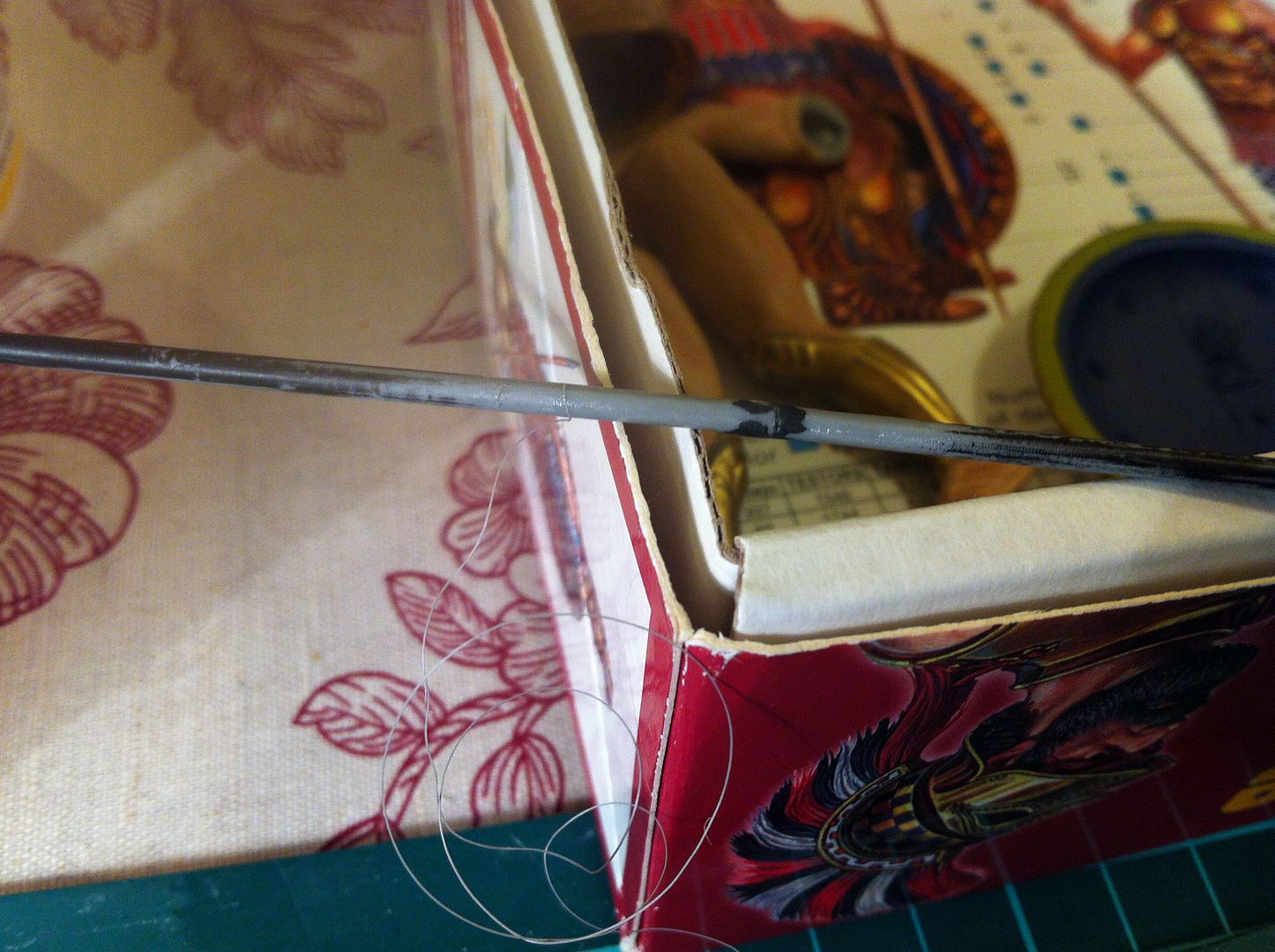

Got a good bit done tonight .That monster 'spear' is in two halves .I just stuck them together and gave them a quick sand as I was planning on hiding the joint with a string/ cord 'hand grip' made of stretched sprue
Was a bit trickier than I expected , the liquid poly/Tamiya Extra Thin 'cut' the string once or twice
but once I got a good tight 'start' the rest was just like fitting a roll of handlebar tape on a bike !

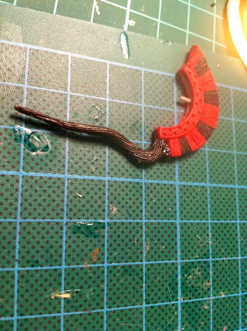

Back of horse hair helmet headdress glued on , big gap will need work .

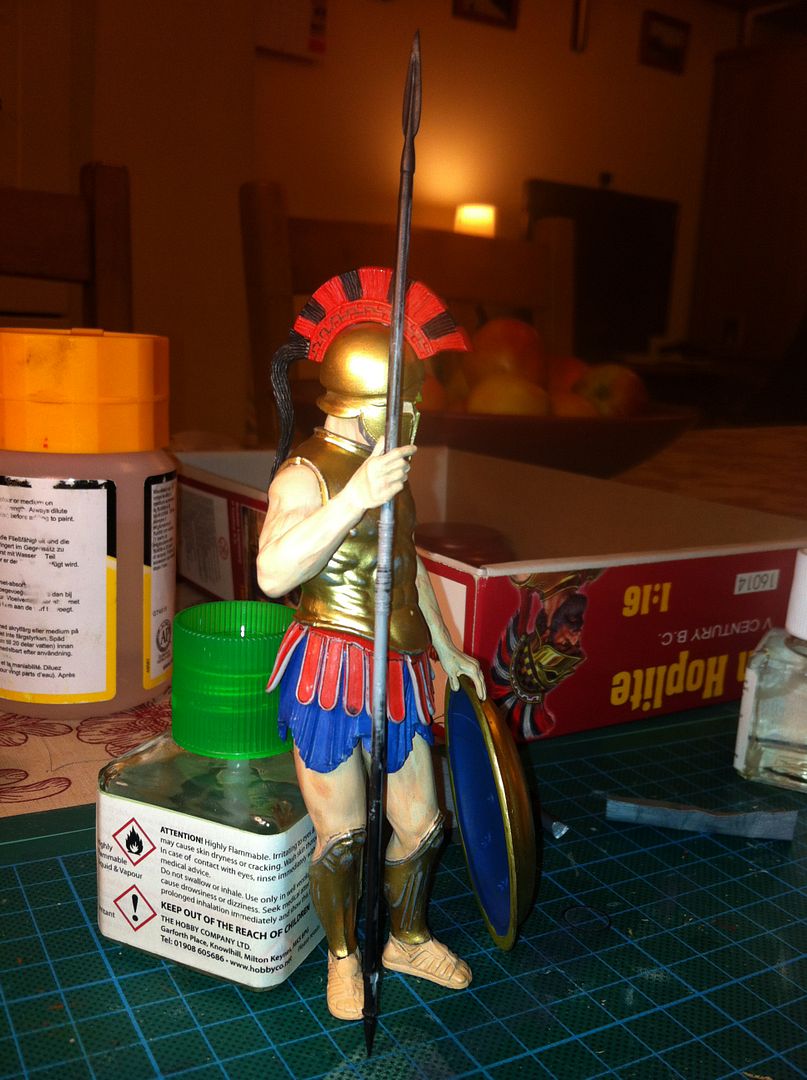

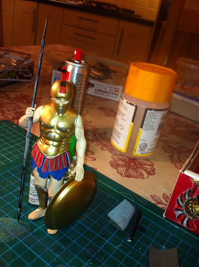

...glued a few bits together .Getting breast plate to sit right was tricky.I guess figure modellers encounter 'daylight' just like plane modellers up inside 1960s Airfix/Matchbox air intakes etc (?!)Nothing I can do about it at this stage ....(Actually ...gluing figure to base would probably make 'gaps' almost or actually invisible -they can only be seen when hes held upside down)
Its beginning to look a lot like ......a Greek Hoplite !
Eyes look a bit 'googly' ,just penned in pupils , worried 'whites' will just make them worse .
Looking mean , happy enough so far .
LOADS of paint touch ups to complete before finished .Decal on shield and maybe a slightly tarted up base ...puddle or 'hole'/grass etc to hide awful feet /sandals ?If I was ever a 'plane modeller' I reckon Im not anymore !

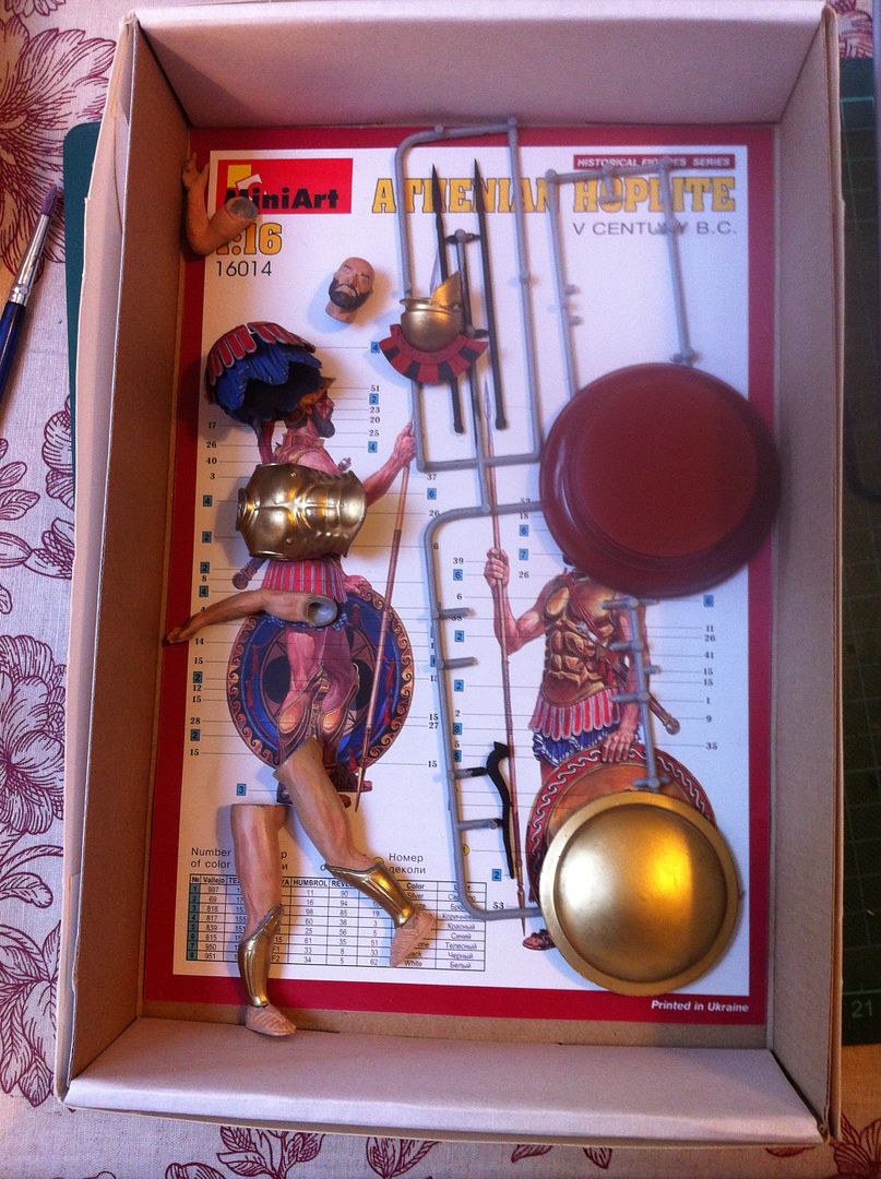

Did a fair bit of painting last night , spear wood and metallic silver tips , sandals etc .Didnt have time tonight .Should finish in next session .
Calling this one finished tonight although far from perfect .Could have done a lot more but enjoying being 'project free' possibly for first time in 2015 .Of course that may have changed by tommorow night :-) Kit not for beginners or those who like a no hassle build but I guess there arent many altenatives and it was something different .Arms ARE moulded well but flash in general is a killer on this kit ...around fingers ,leather 'skirt' tassles etc .Thanks to Group build leader Pat .
